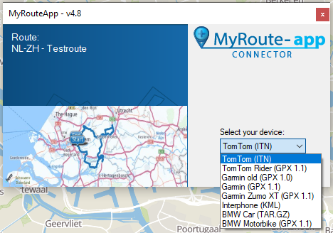

For 'Export'
When exporting a route, you get the option to select the device to which you want to export. It also mentions a file type that is used for this device. You can see the different options in the picture below.
- TomTom (ITN) - Choose this option if you are exporting to an older TomTom device. Older devices cannot read a GPX1.1 file.
- TomTom Rider (GPX1.1) - Choose this option if you are exporting to a newer TomTom device.
- Garmin old (GPX1.0) - Choose this option if you are exporting to an older Garmin device that cannot read GPX 1.1 files.
- Garmin (GPX1.1) - Choose this option for a Garmin device.
- Garmin Zumo XT (GPX1.1) - Choose this option specifically for the Garmin Zumo XT.
- Interphone (KML) -
- BMW Car (TAR.GZ) - Choose this option if you use the BMW car navigation.
- BMW Motorbike (GPX1.1) - Choose this option if you use a BMW Motorbike.

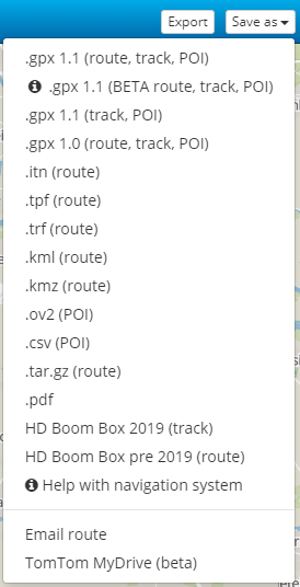

For 'Safe as'
When you 'save' the route file of your choice, it will be saved on your computer. You can then use this route file from your computer for various purposes. For example, you can copy and paste the file to your navigation device as you would to a USB stick.
Below is a list of the different file types in which you can save the information of the route editor from MyRoute-app. There is a brief explanation of each file type.
- GPX1.1 (route, track, POI) - To be used for newer navigation systems;
- GPX1.1 (BETA route, track, POI) - To be used for newer navigation systems, distinguishing between formation points and viapoints (see also Manual Waypoints).
- GPX1.1 (track, POI) - Use this specifically to export only a track file (and no waypoints). This is important for the Garmin Zumo XT for example (also see the Garmin - Exporter manual for more information about Garmin and export).
- GPX1.0 (route, track, POI) - Use for older navigation devices (which cannot read GPX1.1).
- ITN (route) - ITN stands for itinerary. Use this for older TomTom Rider models as these models cannot work properly with GPX files. The ITN file type is the way to drive a route instead of a route-track with a TomTom device. Please note! Exporting to TomTom in this format does have a maximum number of waypoints (for the number of waypoints, see the information of your navigation device).
- TPF (route)
- TRF (route)
- KML (route) - This file type is used by Google Earth and Google Maps, among others.
- KMZ (route) - This file type is used by Google Earth and Google Maps, among others.
- OV2 (POI) - Use this file type to save POI files for TomTom navigation devices.
- CSV (POI) - Use this file type to save a POI file in Excel.
- TAR.GZ (route) - Use this file type to save a route intended for BMW Car navigation (see also MyRoute app & BMW Auto).
- HD Boom Box 2019 (track) - This file type is specifically for the 2019 Harley Davidson Boom Box.
- HD Boom Box pre 2019 (route) - This file type is specifically for Harley Davidson Boom Box pre 2019.
- Email route - This option allows you to email the route instead of saving it to your computer. You then choose the file type you want to email in the pop-up window (corresponds to the above file types).
- Plan.tomtom - Click this option to save to plan.tomtom. See the detailed explanation in the manual TomTom - Exporter avec plan.tomtom.
