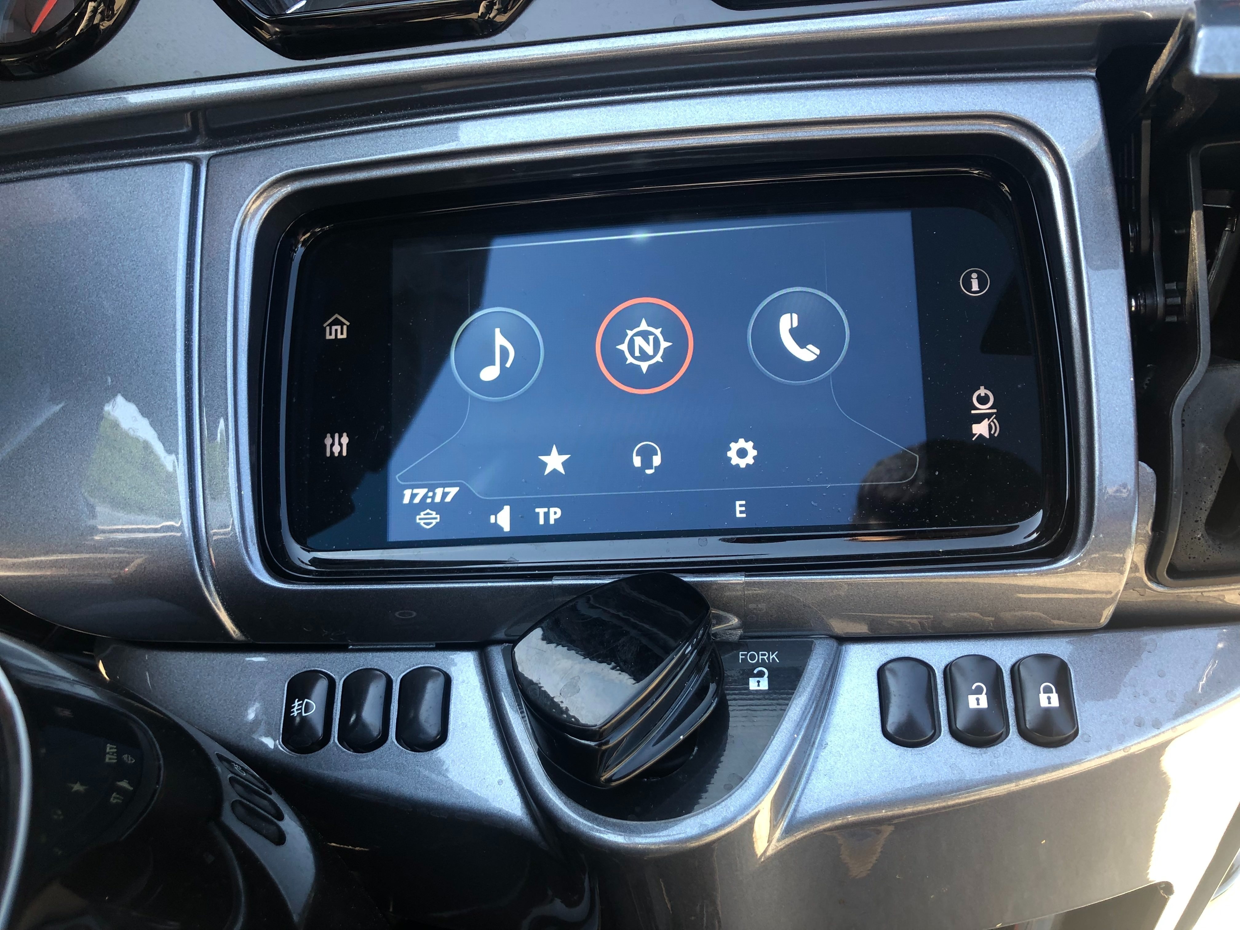

1. Turn on the BoomBox infotainment system and wait until the main menu appears.

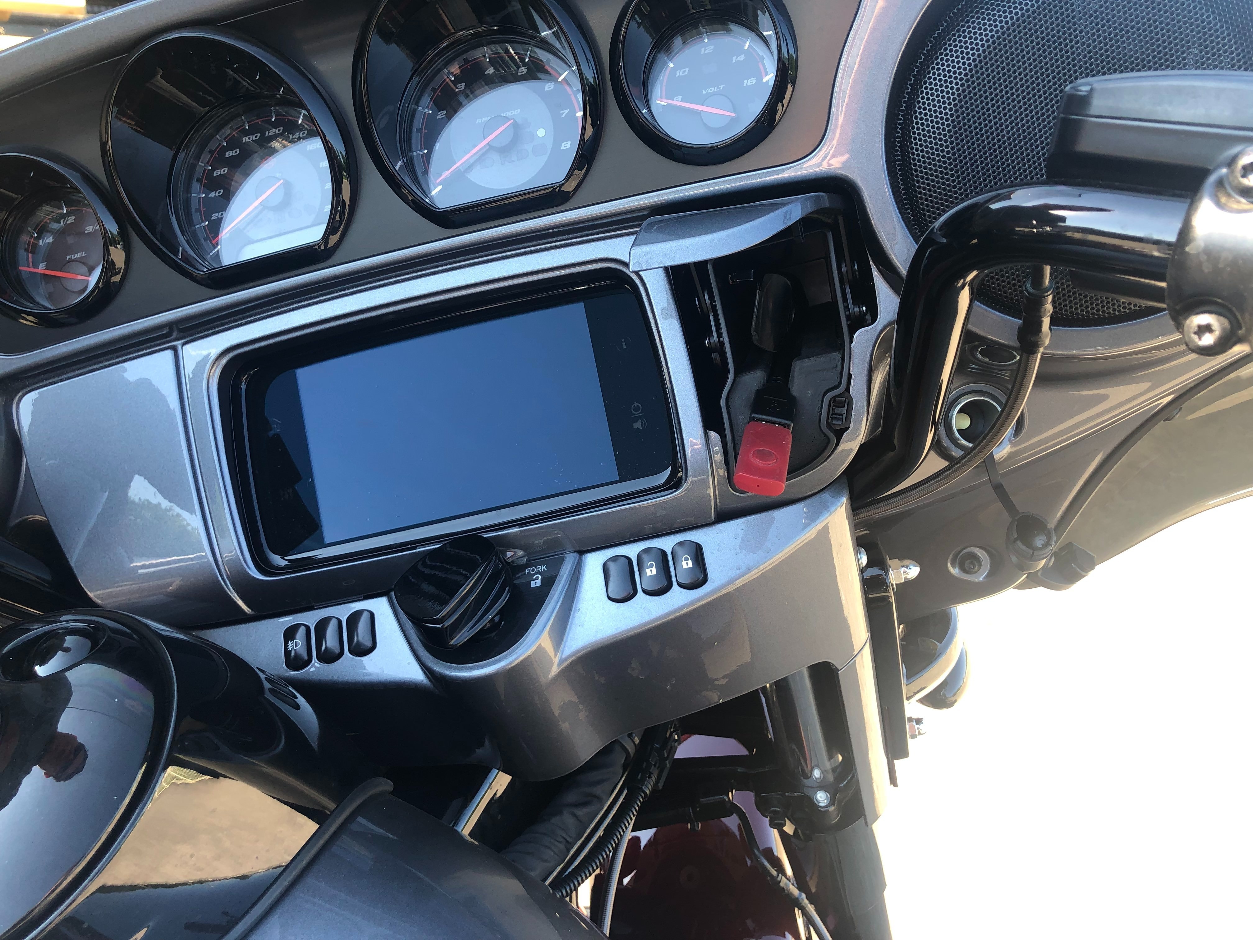

2. Attach the USB stick to your Harley Davidson.
3. Press the “Navigation” (middle) button in the main menu.

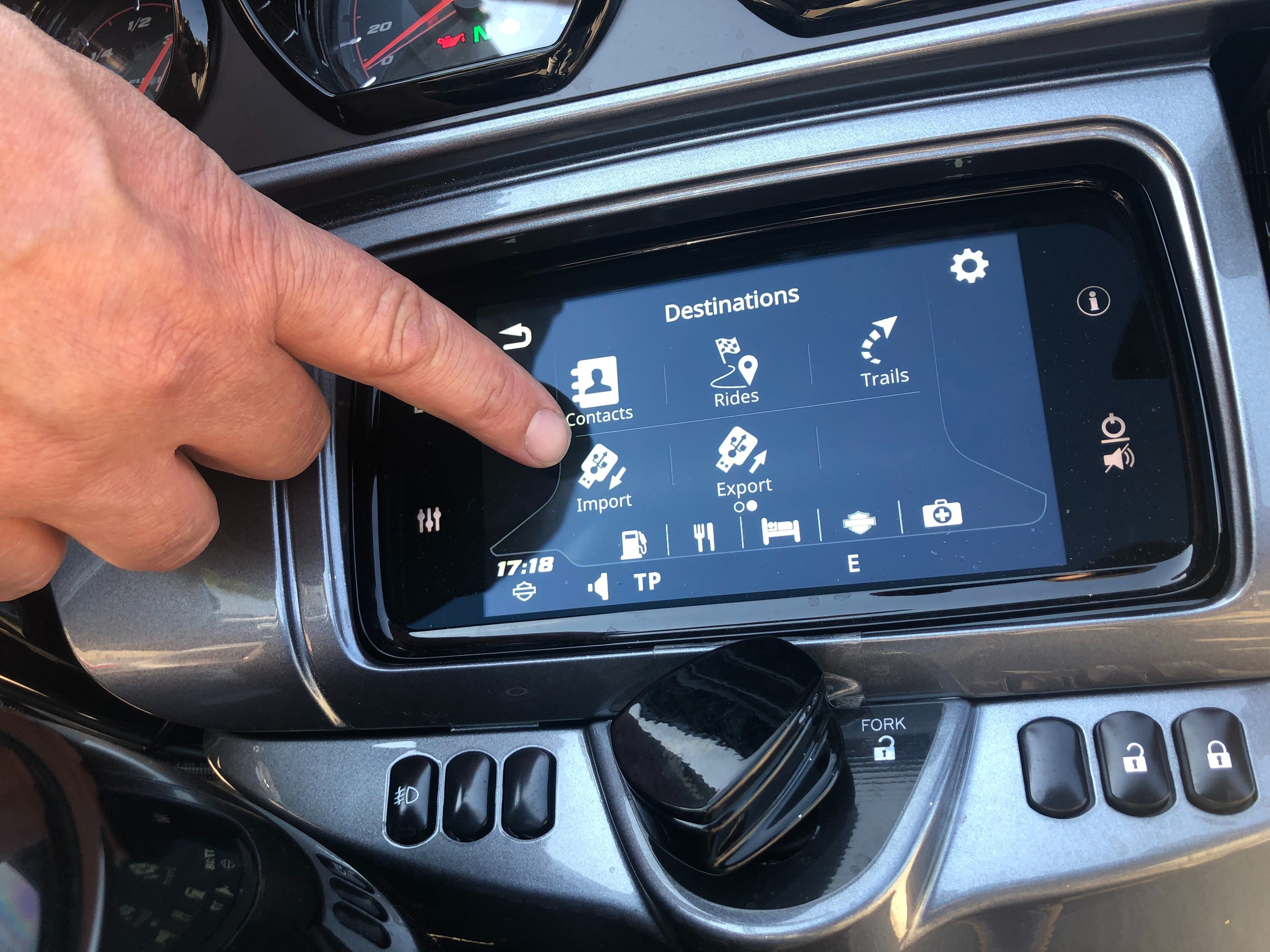

4. Select "Search" (top left corner).
4. Swipe the screen to the left to reveal the "Import" button. Then press the "Import" button.

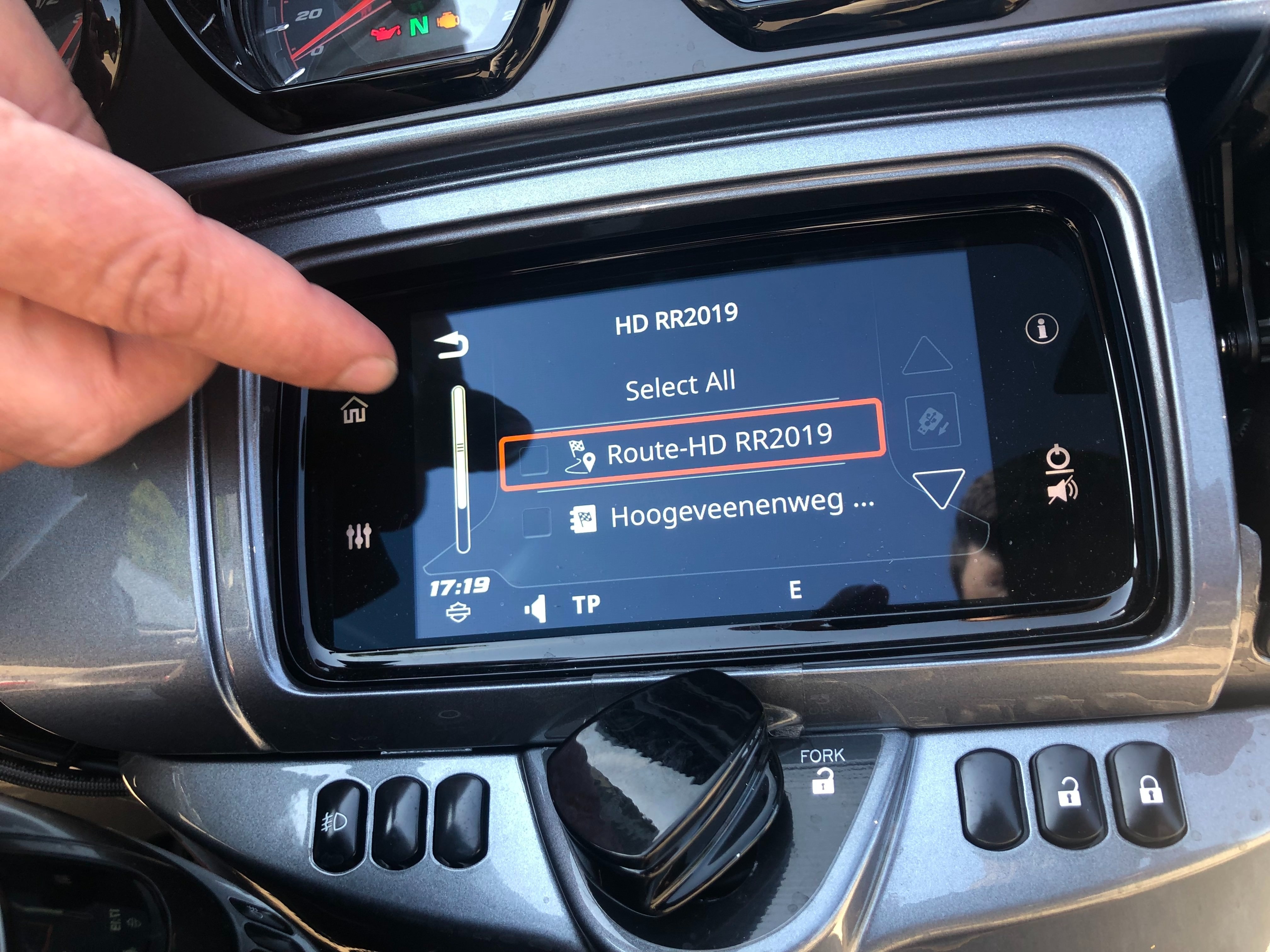

6. Select a route you wish to import.
7. Select "Route-" to navigate by route.
8. Select the button on the right between the arrows to start the import. You might be asked for a confirmation, answer "YES" to the question.

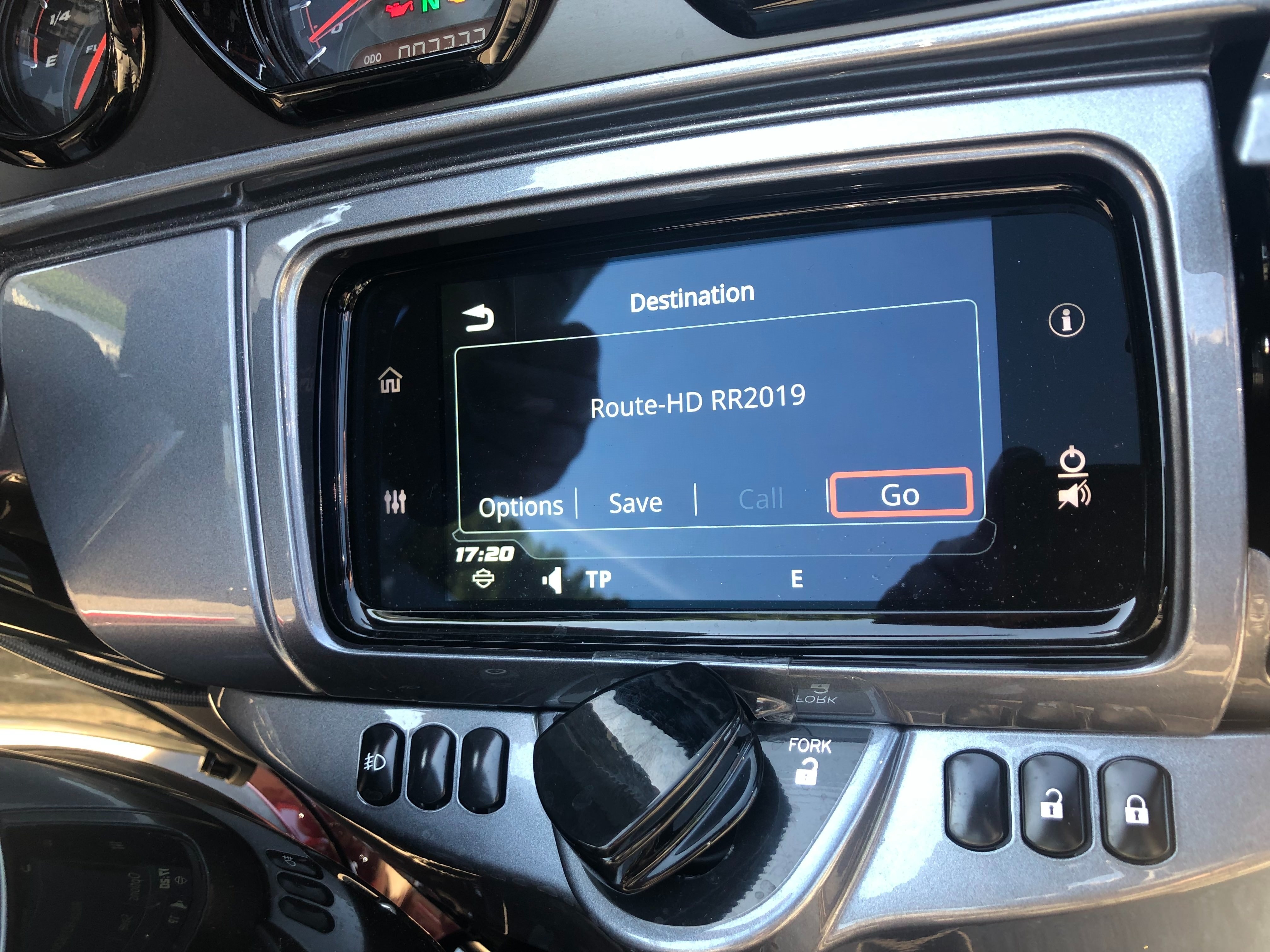

Starting the navigation of an imported route or route-track
1. Press the “Navigation” button on the main menu.
2. Press the "Search" (top left) button.
3. Swipe the screen to the left to reveal the "Rides" button. Then press the "Rides" button.

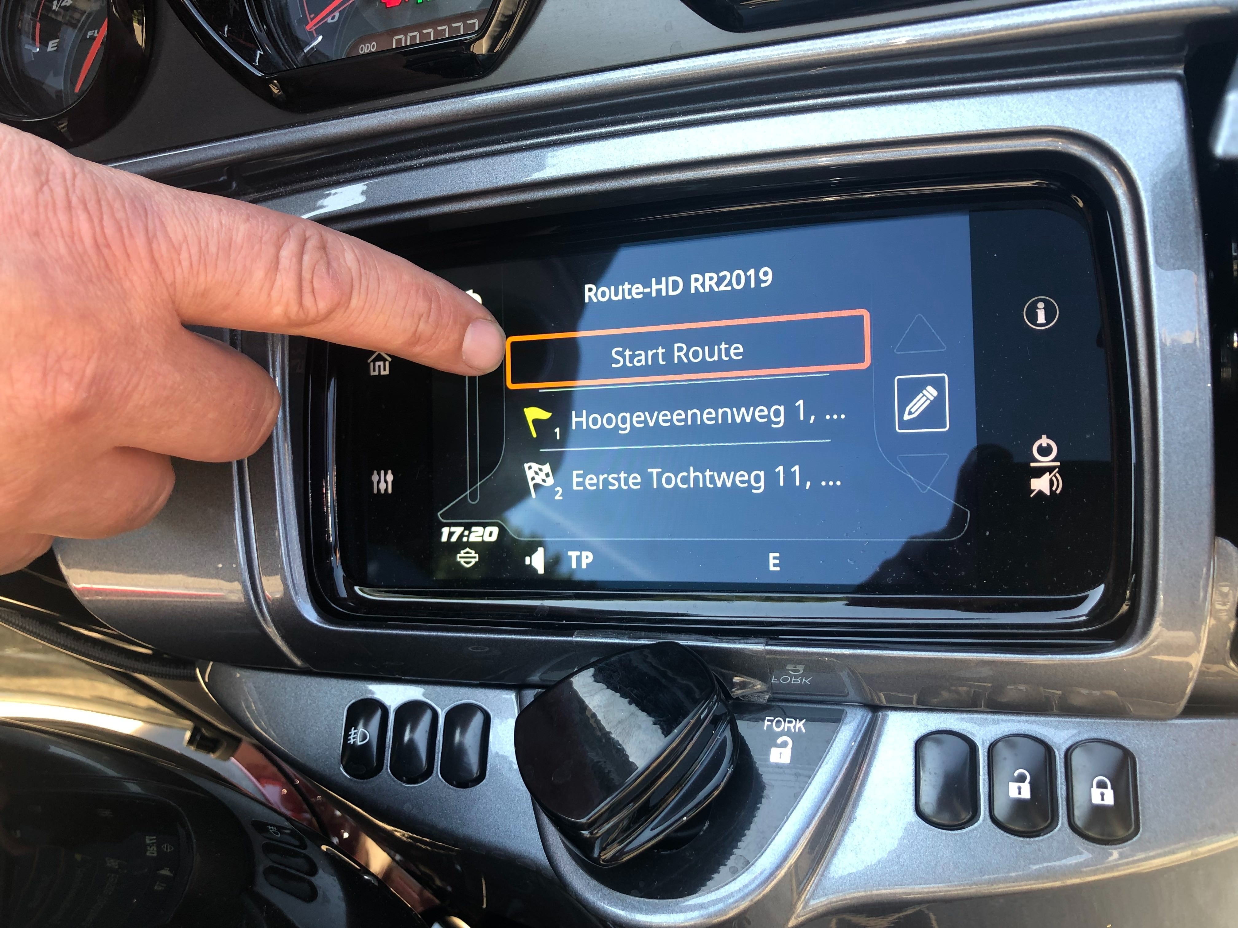

4. Select the imported route.
5. Press "Start".
6. Wait until the BoomBox has finished loading the route. You can track its current progress displayed on the right.
7. Press "Go" to start the navigation.
